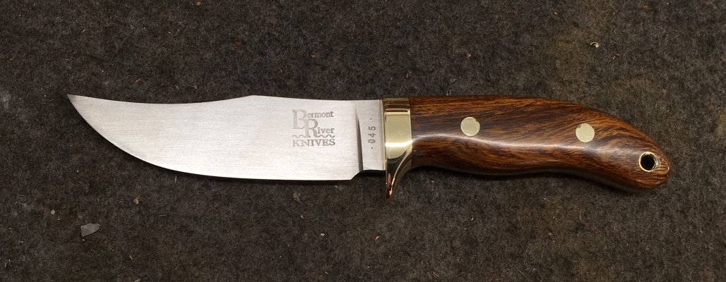

The Whitetail.
8" hunter with 4" blade. CMP S90V steel, desert ironwood handle, brass bolster, pins and lanyard hole. 61c Rockwell.

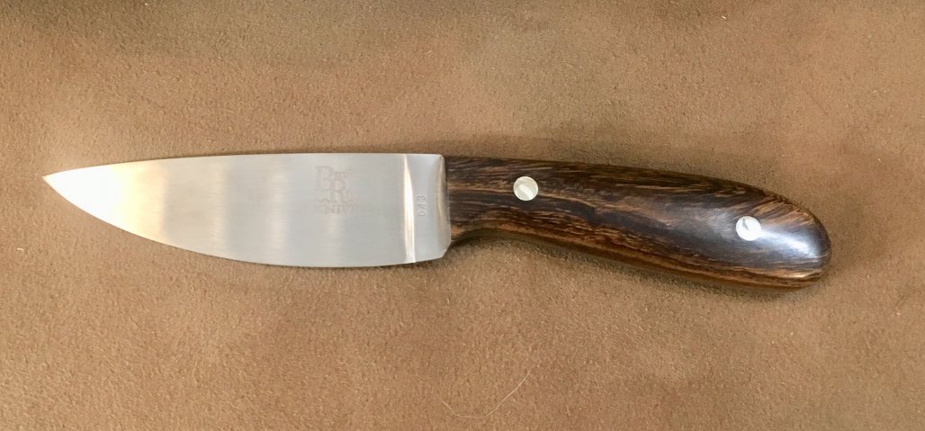

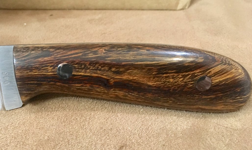

This one is called the "Mallard" . Most knife makers have a variation of a "bird and trout" knife for light duty, small scale work.
This knife is 8" long with a 3-3/4"blade. The steel is Crucible Industries CPM
S90V at 60.5C Rockwell. The handle is desert ironwood polished to a gloss finish held on with stainless Corby bolts. The sheath is .060"Kydex custom molded to the knife.

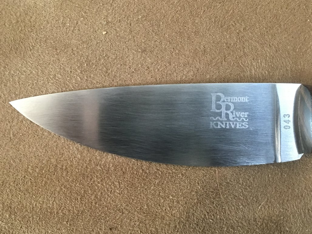

This is the Grizzly. The blade is 3/16" thick CPM S90V at 60.5HRC. It is a full flat grind with a thicker edge at the rear to handle the tough duty requirements of game processing. The handle is desert ironwood with brass Corby bolts and finger guard. The handle is buffed to a gloss finish and melts in your hand. Thanks to Jen Kaiser for the great photos.

Latest from Bermont River Knives. The Grizzley in a hidden tang version. The steel is CPM S90V at 62 Rockwell with a Stainless steel finger guard with yellow accents. The handle is desert ironwood with a mo robust profile. The blade is 4-3/4 long by 1-1/4 deep with an overall length of 9-1/4. The sheath is made of dark brown Kydex and is custom molded to the knife. This would be an excellent big game knife or for whitetail.
This is the Mallard. This full tang model is made from CPM S90V at 62 Rockwell. The handle is desert ironwood held on with nickle silver Korby bolts. The blade is 4" long by 1" tall. The overall length is 8". The edge of this blade is tapered from .020" at the tip to .035 at the rear of the blade. This make the blade good for delicate work in the tip and if more heavy duty work is required then the rear of the blade is used. The sheath is Kydex that is custom molded to the knife. This is a great little multi purpose knife that could be used for fish and birds and even light work on a deer.

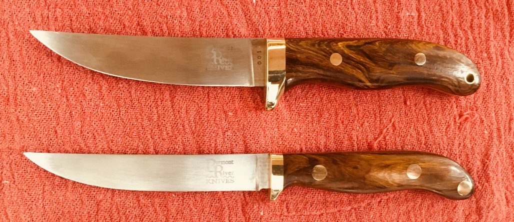

Boning knife top, fillet knife bottom
