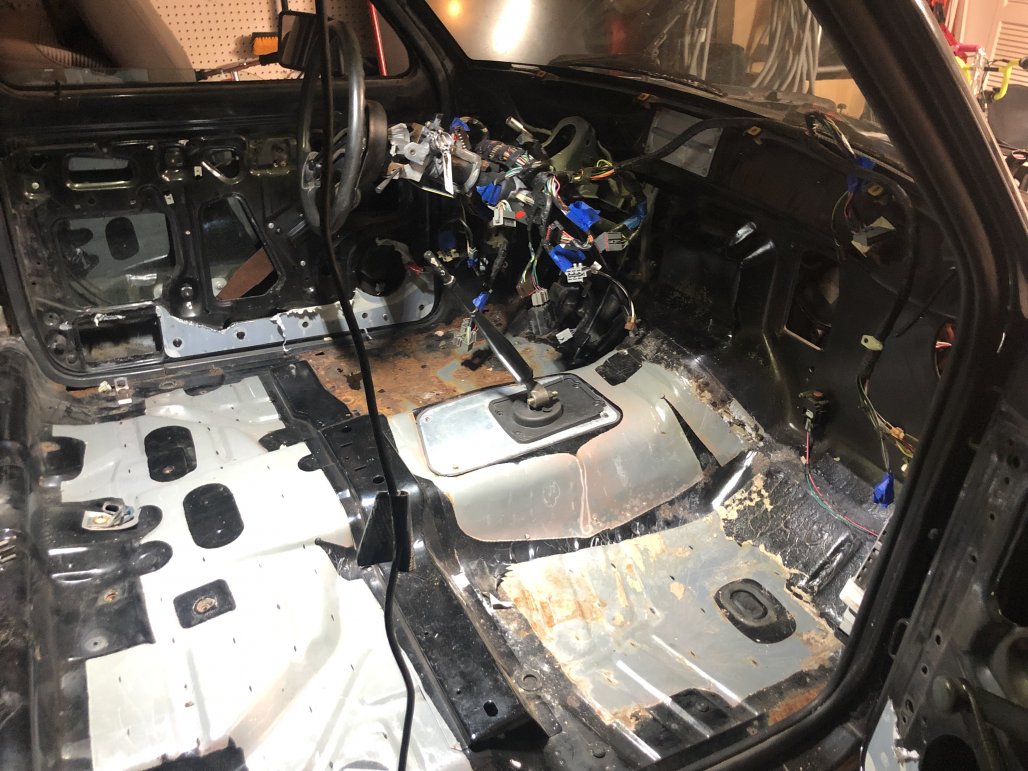

Since my ADD does not allow me to stay on one part of a project until I do something else, I decided this weekend would be all about the interior.
Now, if you have never tried to take a dash out of a vehicle before, let me give you some advice... drink as much beer as you can while still maintaining vision... Then and only then will you discover the one true way to get the dash out. Brute force.
After removing 4.2 million nuts, bolts, wire connections and various other do-dads that have no earthly meaning in a ‘92 ranger. You will find a chisel and large hammer and start breaking apart the damn channel they have wires going through.
103 F-bombs and 4 bloody knuckles later ... the SOB is out.
I can only imagine what a wire harness on a 2019 vehicle looks like.
So. I have to unwrap each one of those wire bundles and remove all the stuff I’m not using. All the HVAC controls, audio crap, interior lights, seat belt sensors and all those damn warning lights and remove each wire loop...
Or I just cut the connector off. Cover the open wire with plasti dip, and prey it works???
I’m leaning towards the latter.
I wish I would have weighed this thing before I started. I know I have removed over 1000 pounds.

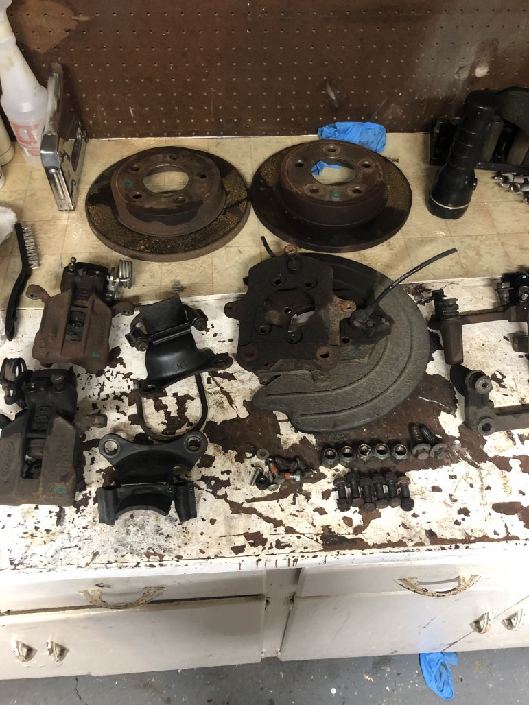

Nice weekend to get some work done and look for upgrades. Found a nearly new rear disk setup off a Mustang today. Almost a direct bolt on upgrade over the rear drums. Major score for $67. Also found an improvement for the front. 95-97 ranger has duel piston fronts... just have to find the steering knuckles.
As you can see, still dealing with a lot of rust up front. But almost all of that is getting replaced.

Got some much needed advice/help with the electrical. “Whatever you do, don’t f with the wire harness Just plug everything back in that still in the truck and wrap all the connectors in tons of tape”. I guess everything is wired in a loop and if you cut out systems your not using, it screws the pooch.
Who says being lazy doesn’t pay off? I had cutters in hand last week and said “I will do that crap next week.”
