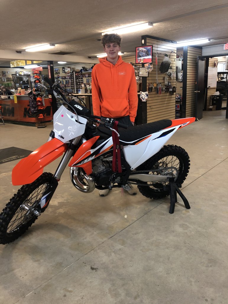

Well we sold one of the kids 19crf250’s and bought a 250sx. He loves it so far, have the last Honda listed and probably getting an SXF. Take me to KTM school. Is there anything I need to do different on these?

We went to OIR Sunday, took him a session to get into his groove. After that he looked normal on it. I left the clickers in standard, started at 149psi as a recommendation off the net. We finished at 134 psi as the spot he liked the most. His only complaint so far was that rear wouldn’t settle. We have a lot more break in time to go but might have to drop the rear spring rate. He’s tall but weighs nothing at 6’2” and 155lb.
Oh - and F-Yeah on the two stroke -!!!!!
