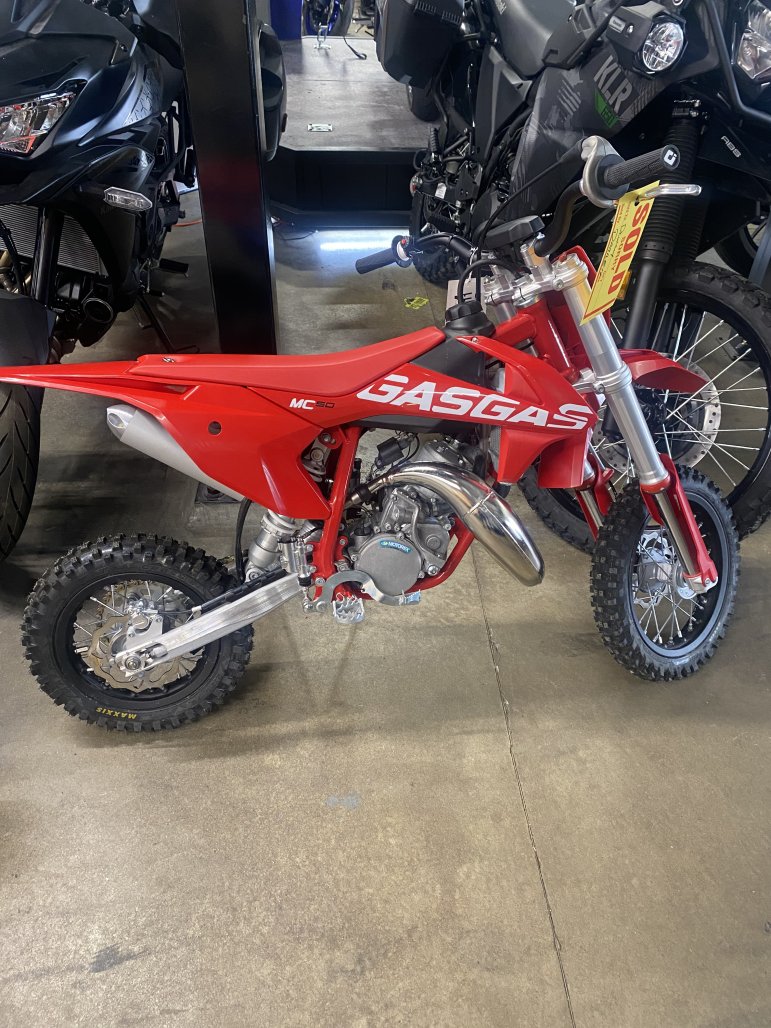

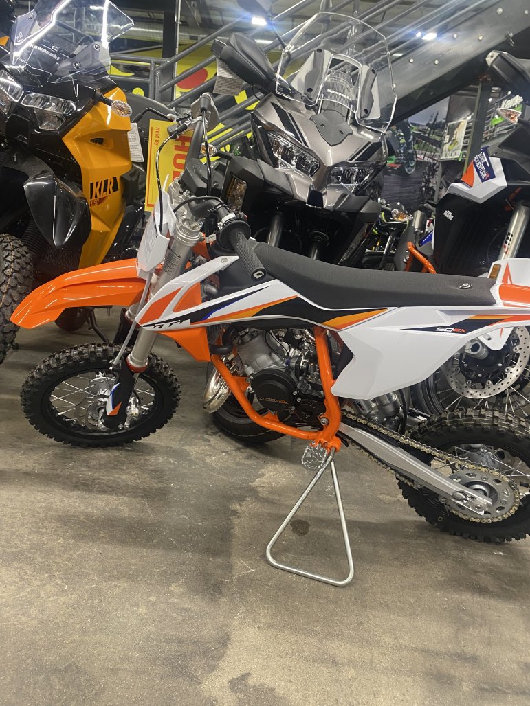

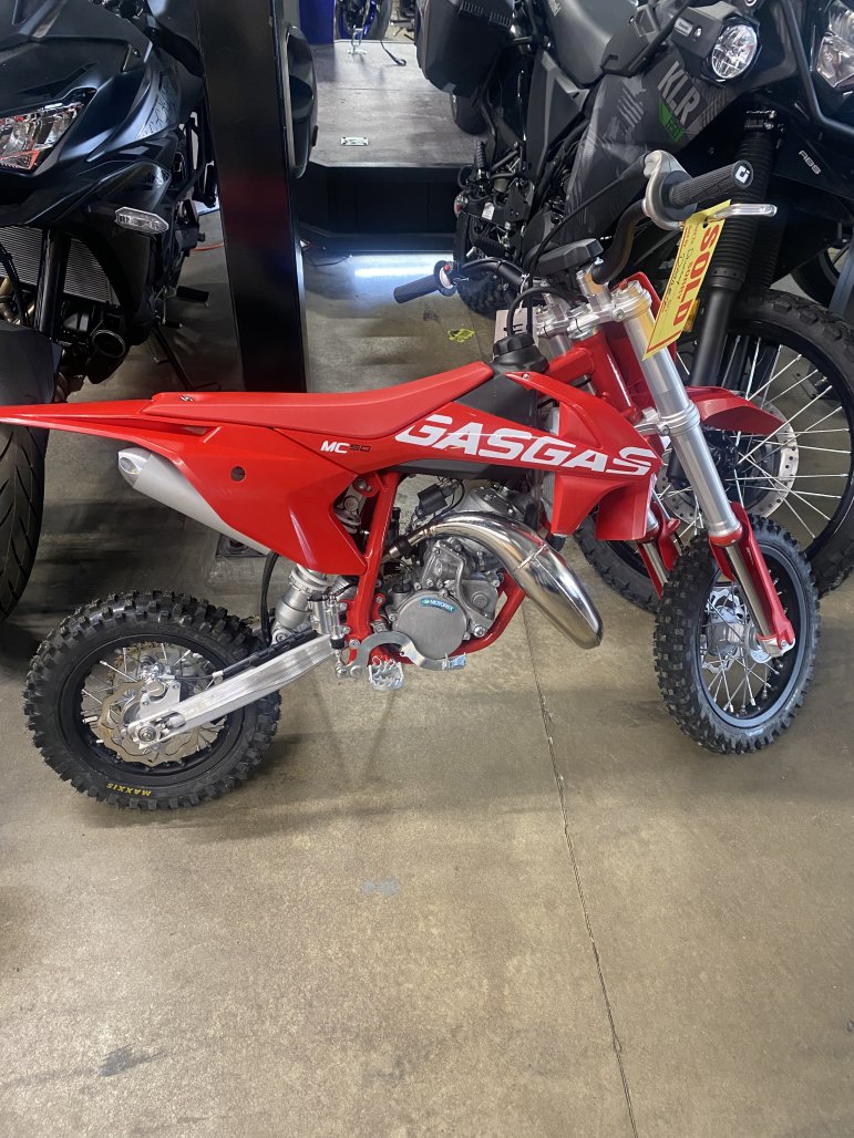

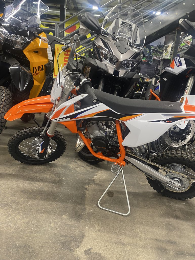

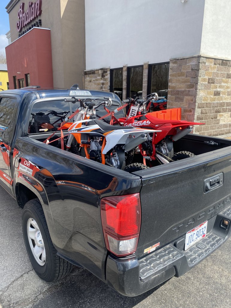

So I went and did a thing today. Drove from Cleveland to St Louis and back in one day to buy 2 bikes from a dealer out there. Got a killer deal on brand new 2022 GasGas and a KTM 50. Saved myself about 1200 on each bike compared to what dealers are asking for 2023’s. So I left at 4am and just got back at 10pm. What a day.

So now that I got this 50 what’s the best way to maintain it. What oil do I run? What 2 stroke oil runs the best? Is race gas better to run? Which race gas? How often do I change the oil? Is it hours or rides?
We ran/run Amsoil Dominator. Was 60:1 in the KTM. We run 50:1 in the Cobra. I also ran ethanol free in the KTM in the end. Toyed with Cam2, but in the end thinking pump gas is fine.
Change the tranny oil when it's dirty. Early on, it might stay clean for a couple/few rides. As the clutch wears, it'll get dirty quicker. We had the IRP clutch and they suggested Lucas Oil Semi-synthetic if you didn't run their oil. I just run regular ATF now and change it often enough...
Not sure it's 100% as to how you maintain it as much as you maintain it often. Stay ahead of the curve for sure. You are there more so due to being new bikes.
Have fun! :)
I’m excited to get into this thing and play with it. Just want to start out on the right foot. I’ve got enough invested that I don’t want to screw it up off the rip.
Is it worth it to just buy the VP premixed fuel? Something like T2? I see an 50:1 premixed VP. Manual says 60:1 which seems like a lot. Is it ok to lean it out a little?
Depends on the end of the spectrum your kid is. Do you need the tiny advantage VP "might" get you?
60:1 is pretty lean. That's 60 parts gas, 1 part oil. I wouldn't go any less than that.... If anything, go 55:1 or 50:1 if you want to fatten it up, but expect oil leaking out your silencer and the need to repack it more often than not. You could use the 2 stroke oil the manual calls for. I never had any issues with it...
