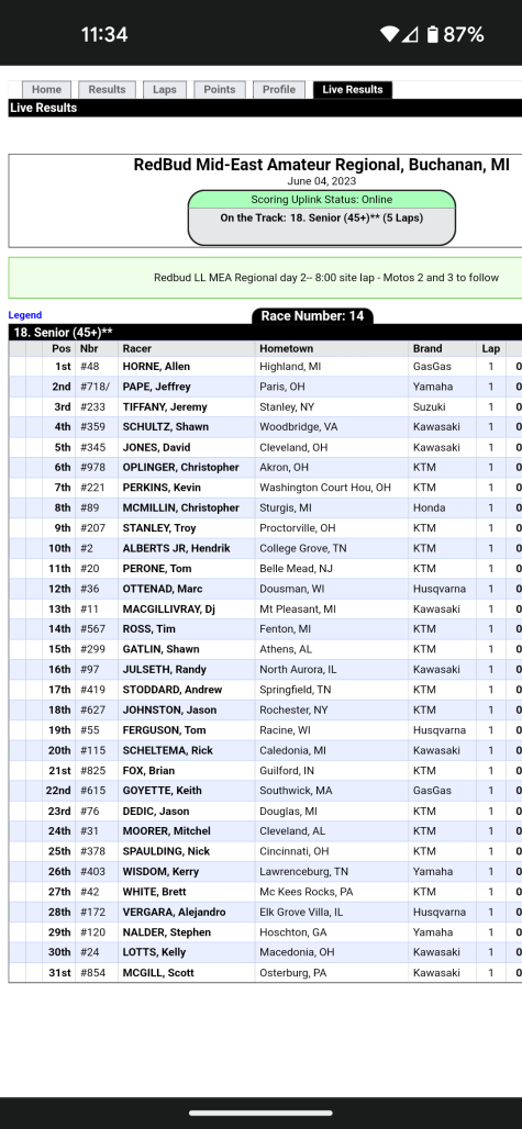

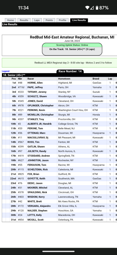

Sitting here watching moto 2s click off.
Ohio boys holding it down in the beginning here!
