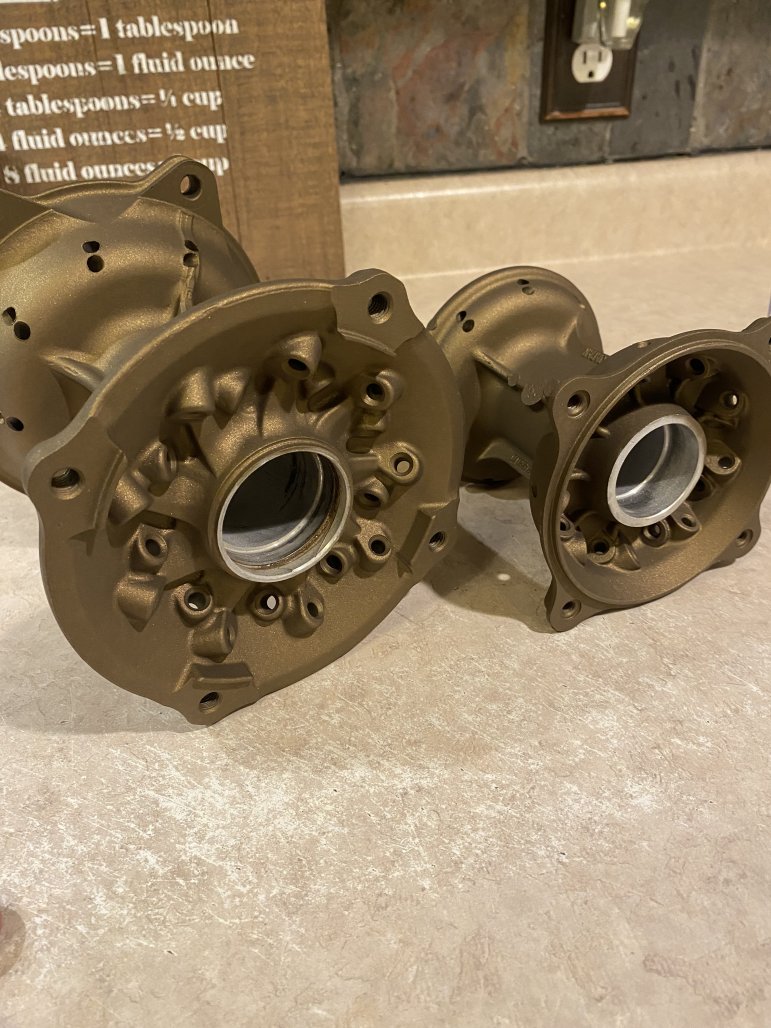

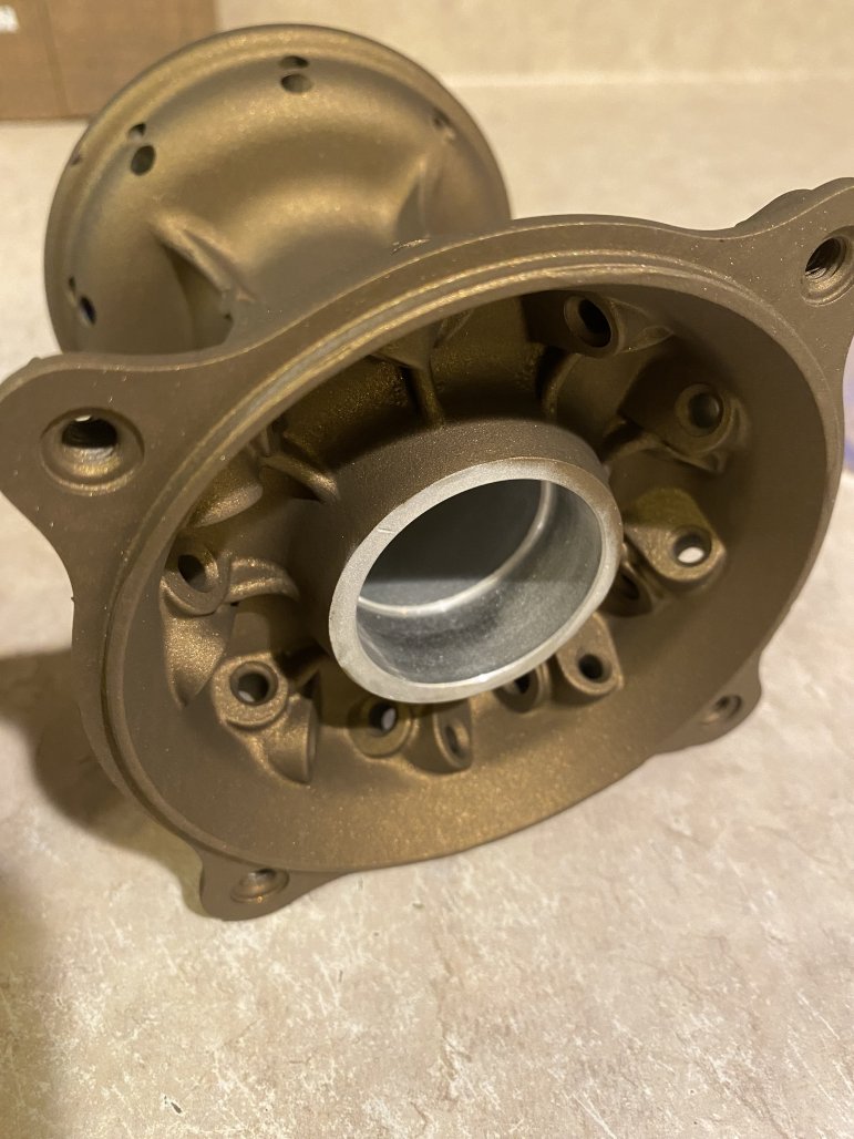

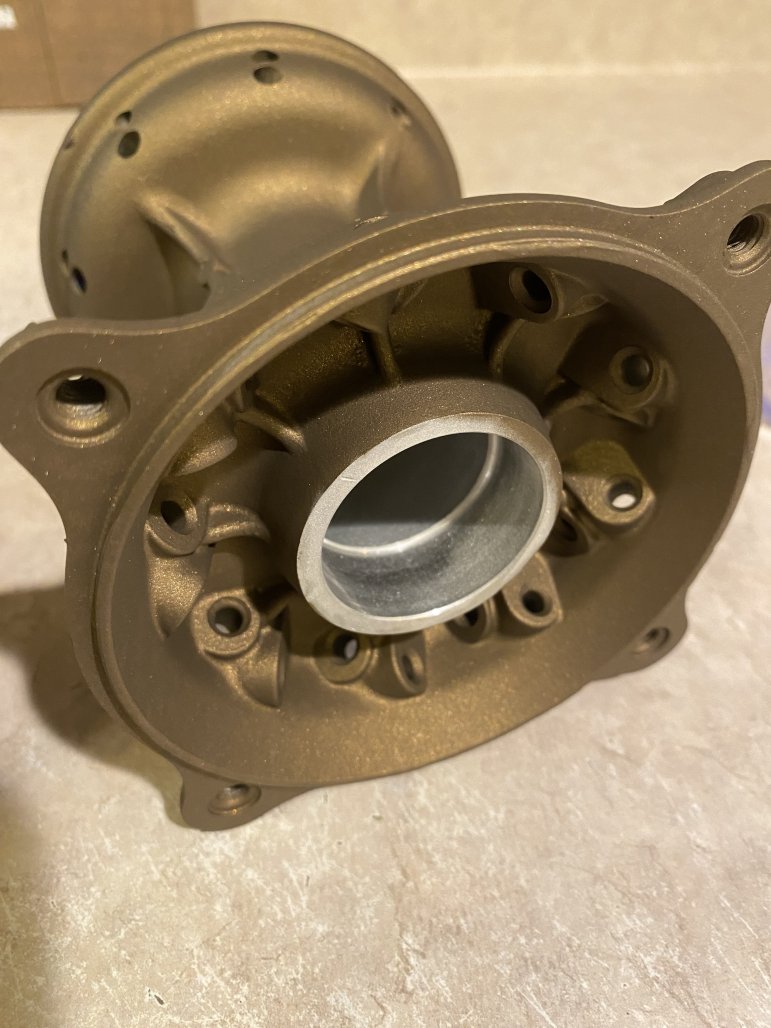

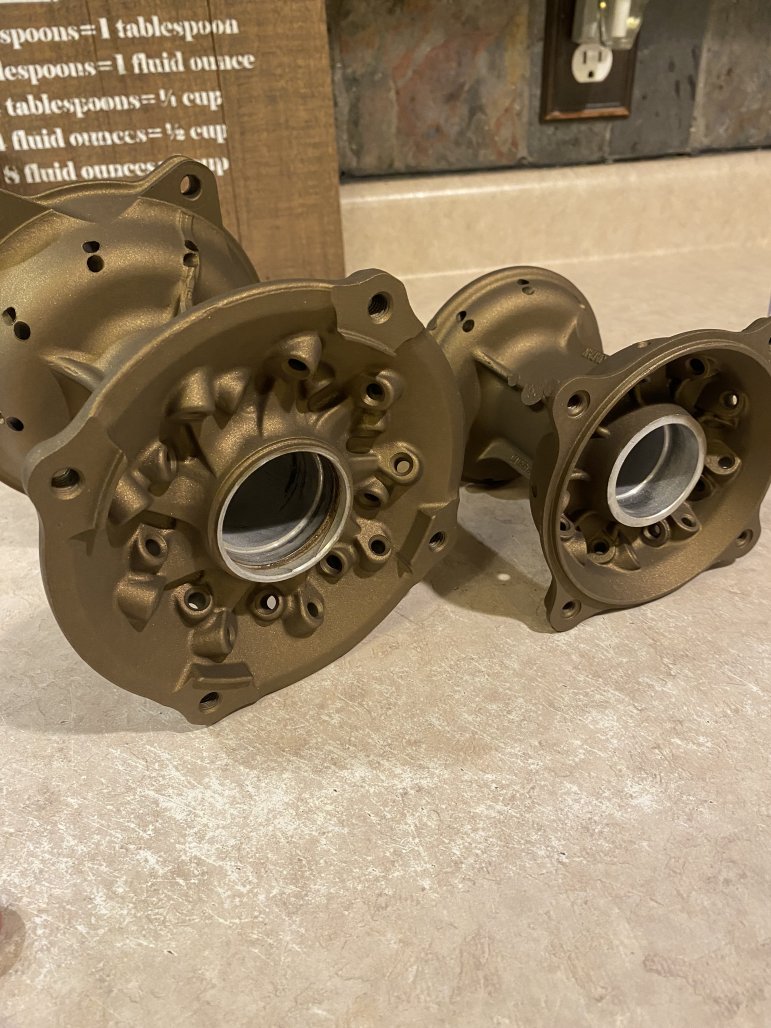

KX build going well so far. I’m starting from
The ground up. I looked into Cerakote and decided to give it a try. Long story short it’s not super hard to do. I made a homemade oven out of a barrel and used a small sandblast kit. Sprayed the hubs and they came out sweet! I’m gonna do the clamps next and then order a rim and spoke kit.

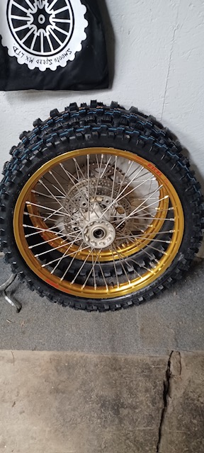

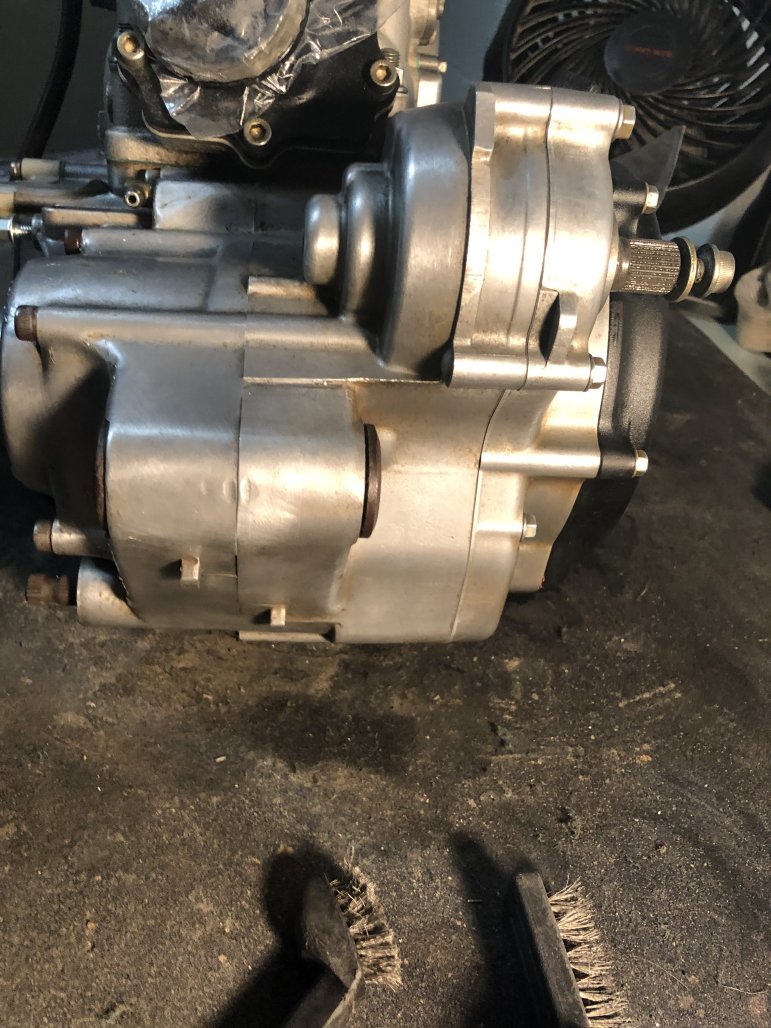

My '04 RM250 build is moving along also. I turned to fellow PitRacer Schaffernocker and his Smooth Speed MX wheel service for rebuild, new rims, spokes, and tires. He did a super job and they look fantastic.

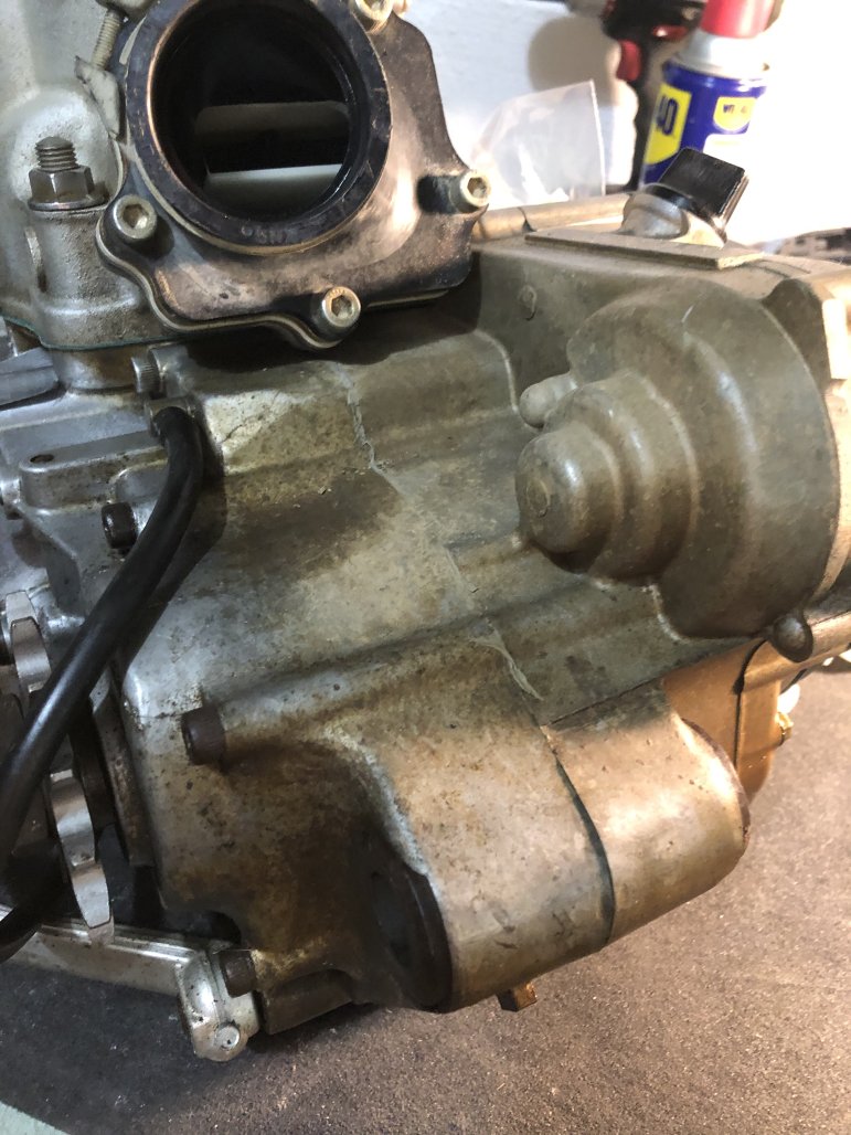

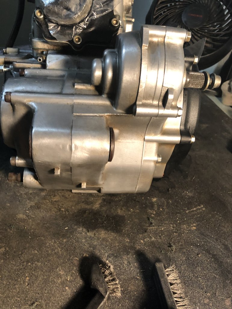

Scotchbrite and wd 40. It's nothing like vapor blasting but can make a heck of a difference with some elbow grease.

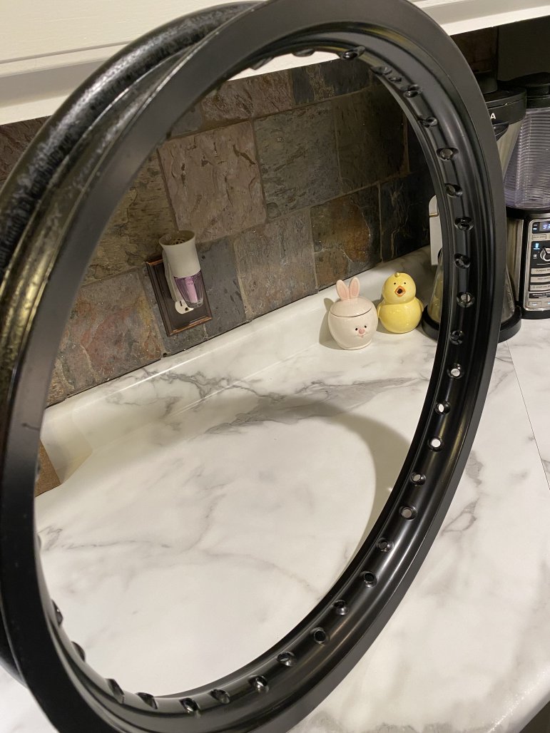

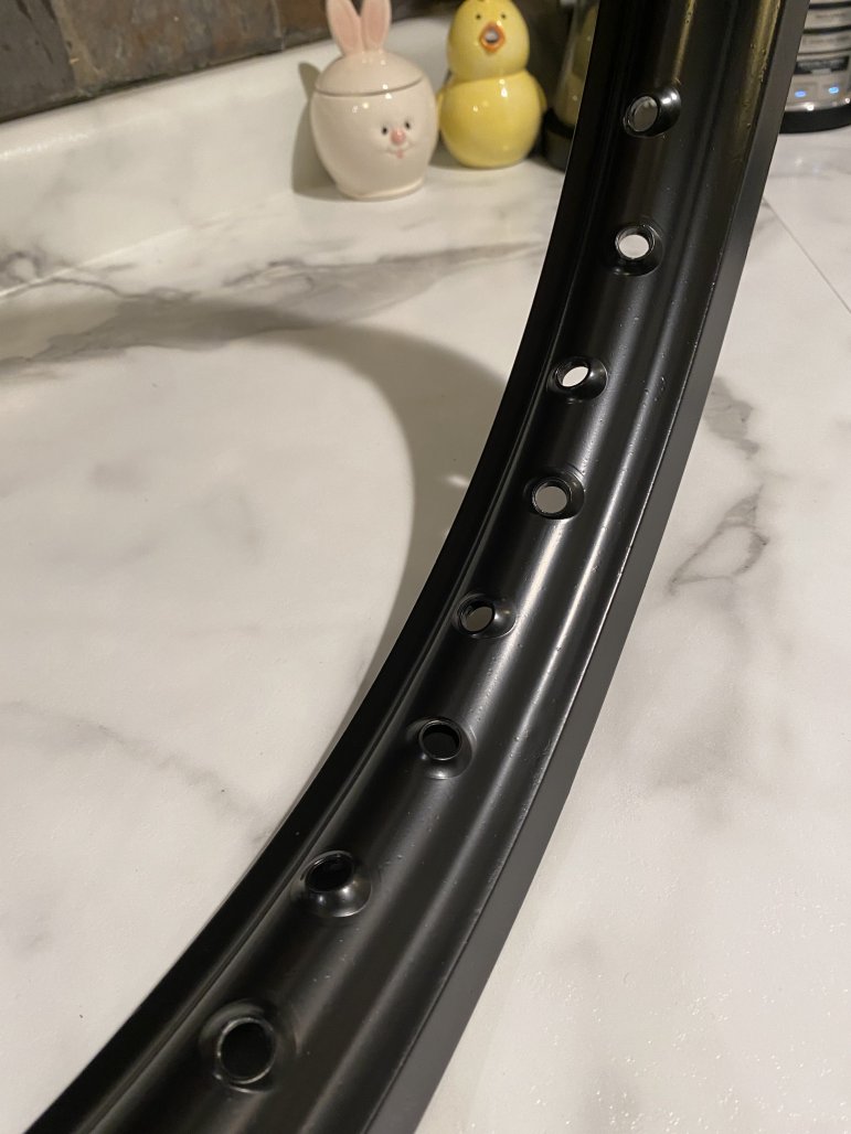

I think the plan is going to be to Cerakote the rims. I have gloss black and the rims are in great shape so it’s worth it to try. Worst case I buy rims and do that. And with how much I actually ride it might take 20yrs to get the bike out on the track lol.
I’ll post pics of the rims once I coat them.

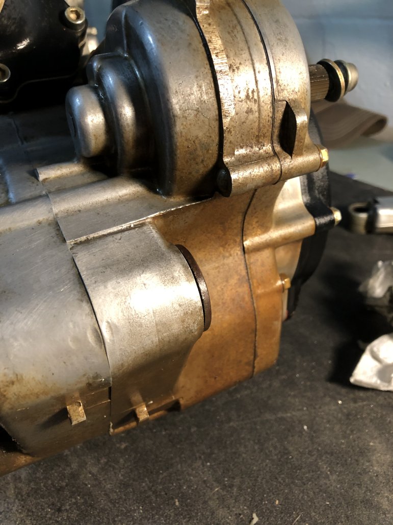

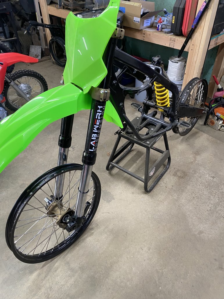

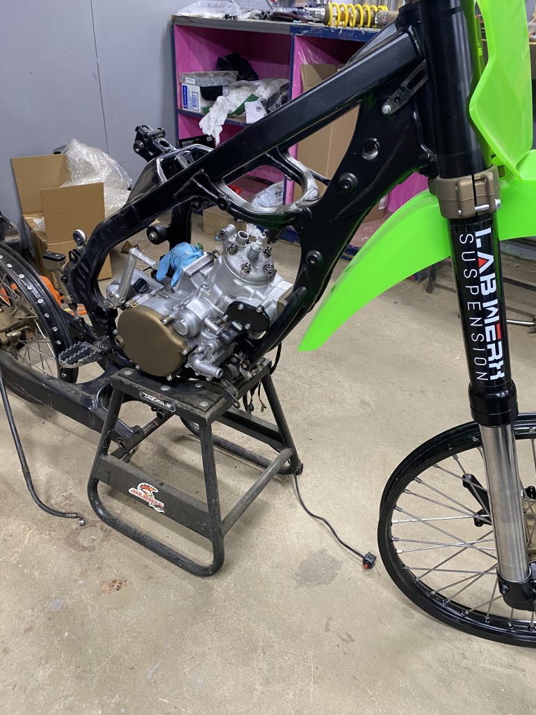

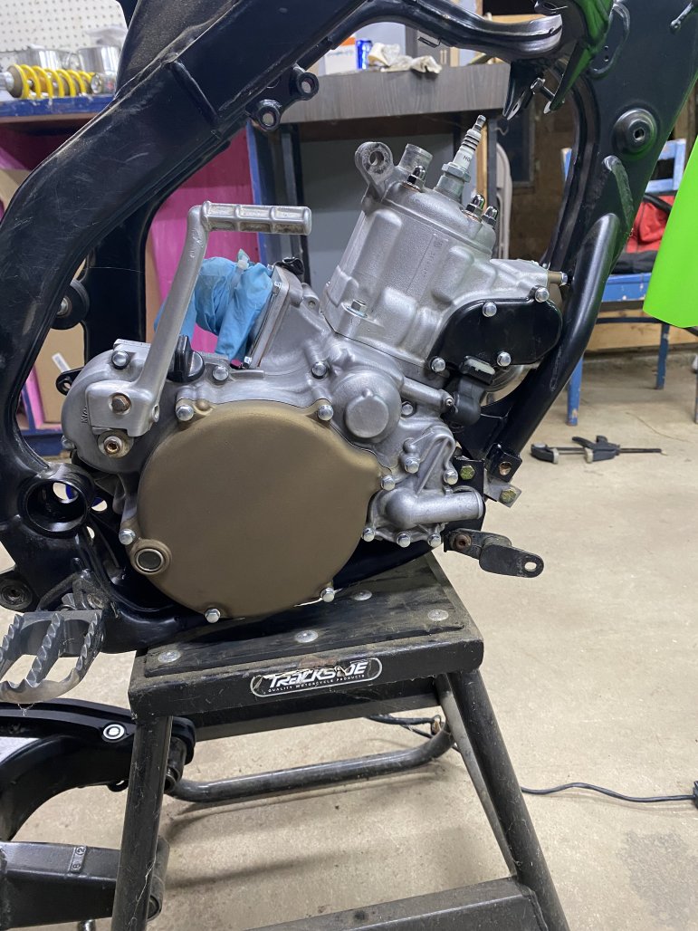

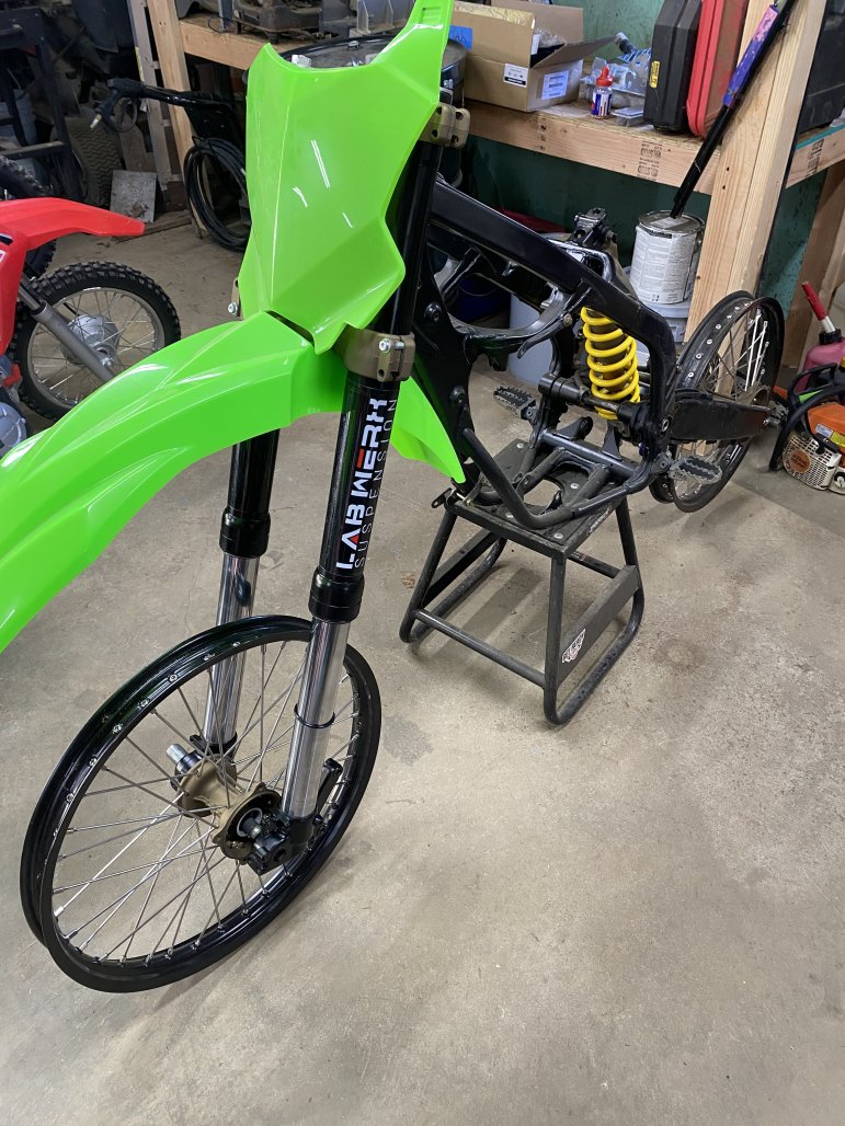

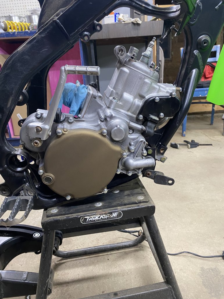

Haven’t posted about the KX in a while but I do have an update. Forks have been Cerakoted and look great. Surprised how well they held up after being rebuilt and put back on the bike. I had low expectations but it looks great. Motor has been cleaned up as best as I could and the wheels have been laced. Just need to have them trued. Here are a few photos.
Also the Specbolt kits are amazing. Makes the motor and forks look so much better.
Graphics and tires in the next month or so.
Shout out to MX724 for doing the suspension for me. Everything looks great.

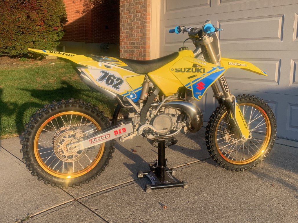

The KX is looking good. I finally finished up my '04 RM250 this week. I liked the restyle kit (a little fabricating) and I am usually happy with DecalWorks. Suspension, bearings, top end, brake pads, clutch, exhaust - most everything fresh with the exception being the bottom end.
Shaffernocker did a great job on the wheel rebuild and tires - highly recommend his work.

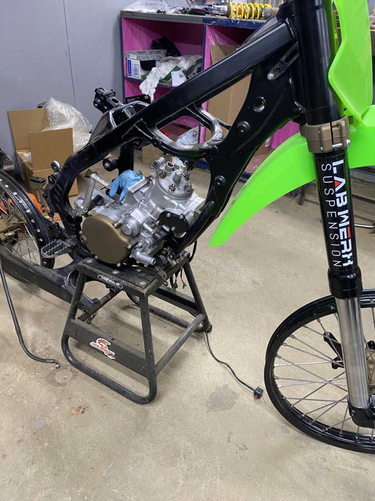

Well the KX is 98% finished. Got a few small things to do on it. Need to put on the fork guard stickers and bleed the back brakes. Other than that she runs tip top! I think it turned out pretty nice. Not everything is brand new on it. Some old some new.
I always loved the Pro Circuit KX so I did it very similar with some other touches like the Hoosier tires.
Thanks to everyone that helped on this. VertMX Graphics. LabWerx Suspension (MX724). Smooth Speed MX.
