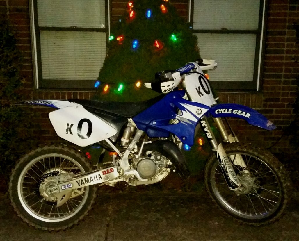

Rode this until dark today. The TMX is working well and I was able cure a temperature change bog with the air screw so I have convinced myself that the 125 needs one of these.

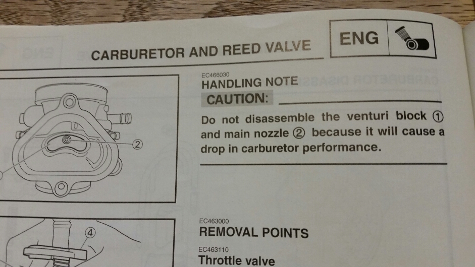

This YZ 125 manual CAUTION is too funny considering that the part likely contains a performance killing defective gasket. My JD kit gasket came with a tiny metal nib on the perimeter that didn't let it seat completely. I also had a problem with the choke not closing completely and finally the fuel needle seat o-ring gasket began to split.
That's hilarious.

LOL. I have different user name on vital. I posted the same thing on there. I agree that the Mikuni is a crappier carb than the Kehin and I also understand the jet it and forget it mentality. I happen to love messing the with jets and jetting. I have a notebook filled with notes, temperatures, etc. The JD referenced part is the block seal gasket that is bad in the video. And yes, the JD jet kit is just that, a pile of jets. Those are great for people that want to jet and forget. It's 95% of the way there. I enjoy trying to get the last 5%!
