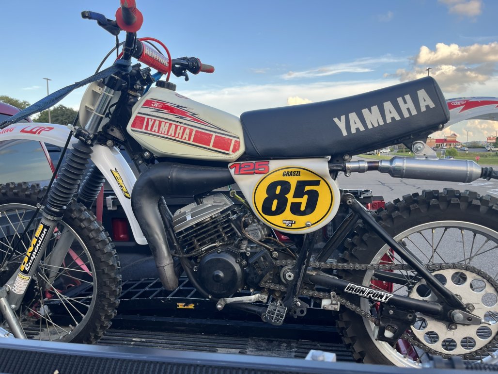

Don't forget this guy on a 77 YZ 125
I recently just purchased that bike back with all white plastics in euro style

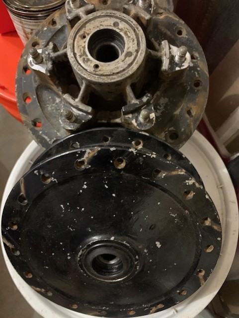

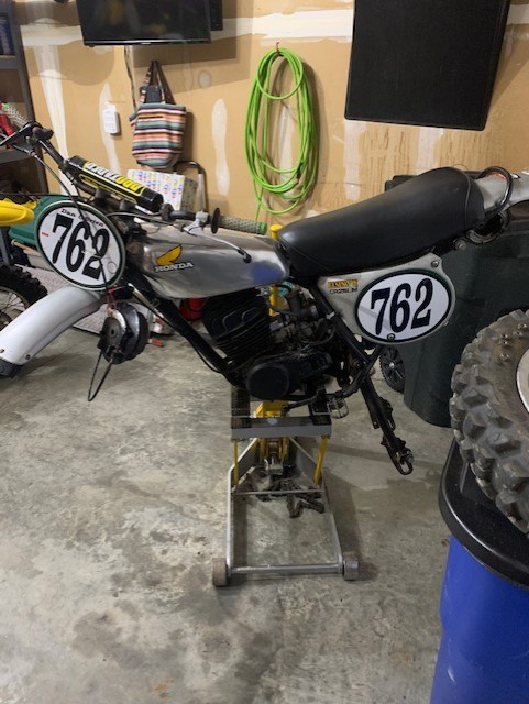

I pulled the wheels and suspension apart on my Elsinore; ready to get it back together. It is so rock solid and reliable but had a few bent spokes and crack in a rim that needed taken care of.
Hope to see you all later this spring and summer - DanO
