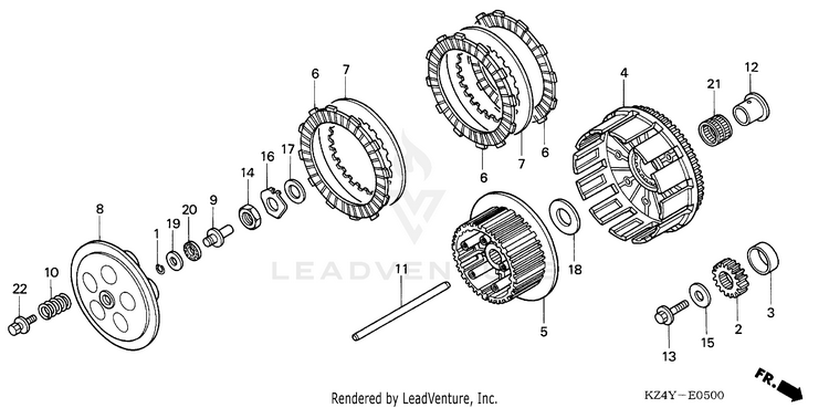

2004 CR 125 Fiche -

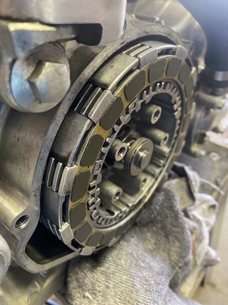

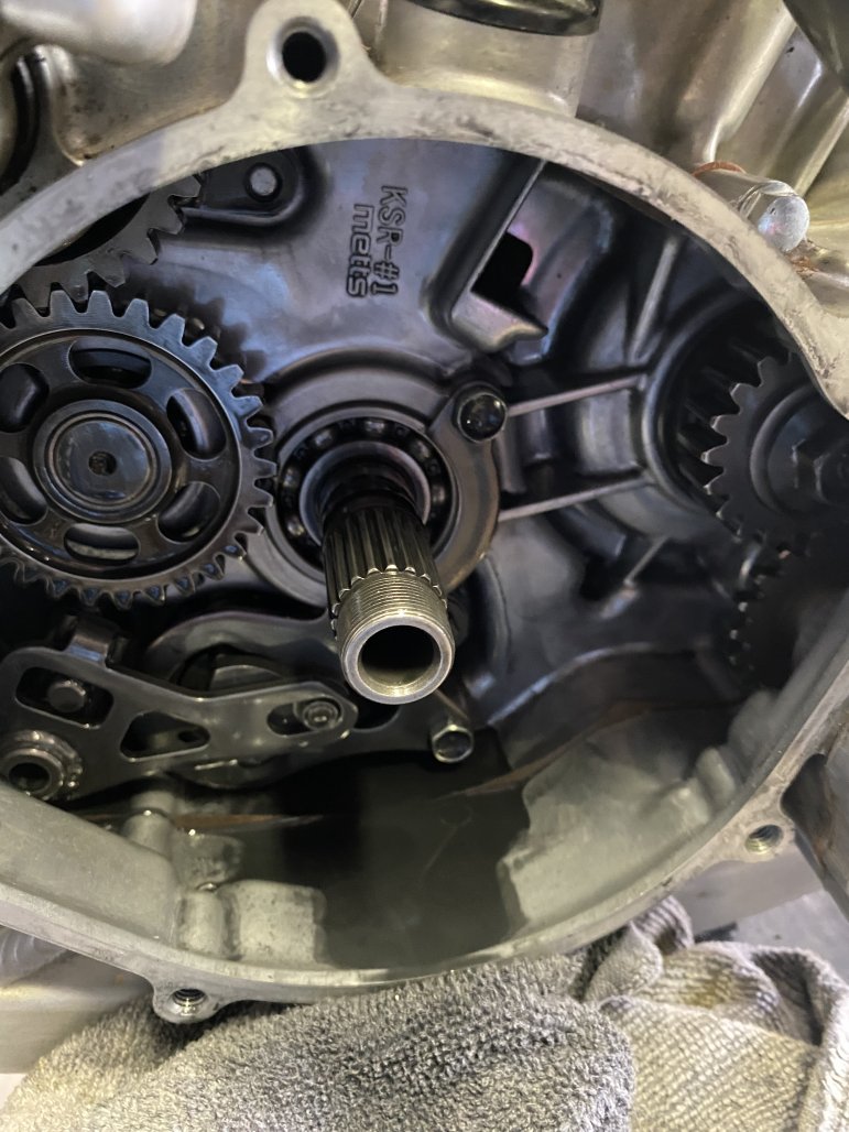

I took apart the entire clutch. Basket and all. Put it all back together. Everything seems correct. Nothing out of place
Also I started with a metal ring then fiber. And ended with a fiber one. Based off what I read that’s how it goes. 7 metal 7 fiber.
Measured the pushrod and it’s 7 1/4” which seems to be the standard.
Also mic’d the plates and they are 3.0mm for the fiber and 1.4 for the metal.

You have the basket, then you start with a fiber. Then metal, then fiber. Building the stack to end up with ther fiber at the very end. That will be the one that will apply friction to thr pressure plate
How do you know it’s not separating far enough? Have you had the engine together and running and try to articulate the clutch and it doesn’t work?
also some had thicker fibers for the 2 outter plates. not sure if honda did that or not, and im too lazy to go lookup part numbers right now to see if 2 fibers are different, but maybe check that lol
WINNER!!!!!!!!!!!! We are in business. One to many metal plates. It’s perfect.
