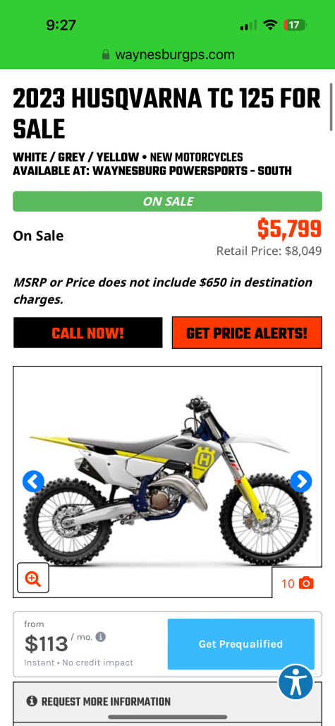

A ny one seen a deal on a new 125?

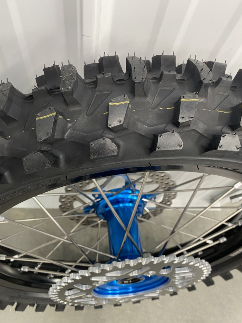

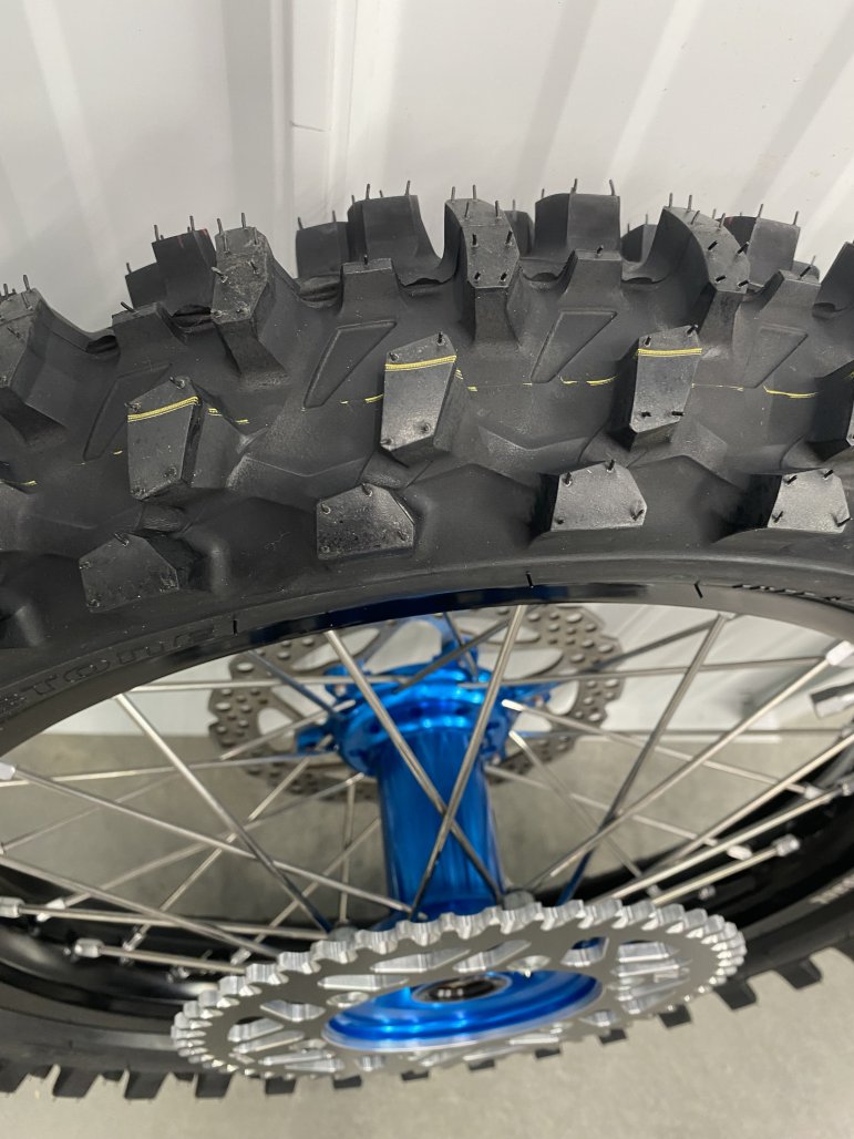

2023 125 project turned out sweet! Still got some tweakin to do, ran out of time before he headed South. He said she ran pretty good.
Credits: DH1 vapor blasting. Amazing.
Powder, BD powder coating.
SRS suspension.
FMF Racing.
Hinson clutch components.
Bridgestone Tyres.
And then there’s
